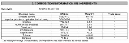

I’ve settled on using Lock-Ease. Graphite suspended in a solvent that evaporates after application via a Q-Tip (cotton swab). No need to wipe outside of case neck. If not available in your country, I’d imagine that there are local equivalents!
