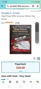

Here brother,
I have been referring to this book alot lately.
It has to be by far the best book on rifle accuracy i have ever read. It explains everything
There is a cool section on savage arms floating bolt
How different rifle perform and why
Load details
Important math equations for accuracy nuts.
This book opened a world of knowledge for me..
Maybe it will be helpful for others also
Its worth
2800$.with the headaches and money it will save you
.but sells for 28$
Dot go buy a sleeve of chew
Dot go out for a 12pack and smokes
Skip the restaurant at break time and pack a lunch.
What im say-n is find 28$ and buy this book and read it over and over untill you comprehend its information.
Hahaha
This book sits in my reloading library because it has information i constantly referring back too
But thats just me.
Just trying to be help and spread the accuracy ❤️ Luv
