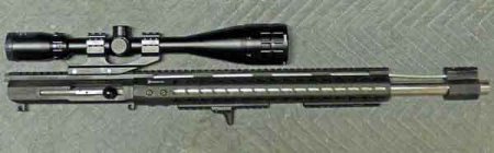

I wonder how much the carrier wobbles being cut off at the rear.
Sort of like piston skirts on a engine?
For the bolt with no gas rings isn't the clearance on the bolt tail sets "wobble" and the gas rings conform to the bore? They are compressed but not bottomed out. Wouldn't that let the bolt move in the gas rings (up to the clearance of the tail in the carrier?
Comparing the Receiver cutouts on a Left Side Gen2 to the BOLT receiver you can see that the front cutout leaves more metal near the front of the heavy wall on the BOLT model, due to lost metal for the handle cutout.
Guess it will be a while before you can buy receivers and carriers.
The bolt spring is a necessity. Bolt (with no rings :) ) can't be left to slide fore and aft in the carrier slot.
With the spring the bolt will start off with NO pin protrusion. The pin is given more travel not from cam action but the spring compressing.
With little to no Primary Extraction-NO GAS- both models just rotate the bolt until the lugs clear.
Would be nice to have a detailed analysis of any "failsafe" features of the new model.
Like an AD potential, better or worse?

The bolt carrier does go into the buffer tube about 1 1/8 inch. I do not have a buffer in this lower.
