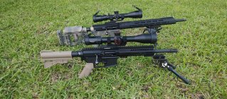

Bear creek bolt action AR
Not sure if that copper in there ( not sure why it would be ) or what.... I mean the whole upper was like $310 shipped so it's probably a $80 barrel so I wasn't expecting anything spectacular at all

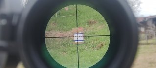

Little tricky because my reticle covers up the dots at 100yd
But anyhow the results. Definitely likes the Hornady more then anything... I definitely tossed the low right shot because....well look at the rest , I actually shot two more just to see and it definitely wants to group...well group better then the rest at least lol

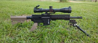

And the latest build, lil .300blk I did with there builders kit.... I will say it's definitely not as smooth as my other one. Lil 10.5" 300blk for slinging cast bullets .
This one was giving me way more fits then my first one so I've don't a few things to it after reading a post over on AR-15 .com where they where really deep diving it. Basically it catches when your trying to rack the bolt and what I can see is there just enough side to side movement in there that if you exert too much force to the right the bol head will catch on the extension lugs....also there something that's causing some friction mid way from the bolt being completely back....idk Ive polished and added a bit of a chamfer/radius to most of the bearing surfaces ... Did have to do anything like this with the last one... Weird ..also cut the "WINGS "off the rear of the BCG and snow I can add some type of filling stock if I really wanted
