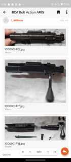

Bear creek bolt action AR
I ordered a 350 legend this morning. As soon as I get it will pull the barrel off and replace with a 16 inch blackout with the gas block turned backwards to close the gas port. Will install a short, fat suppressor. I am putting it together for my 8 year old grandson. That little can doesn't impress me on his 223.
Keep us posted
I have purchased a couple of barrel-less side charging uppers from them over the years and a complete side charging upper. The latter isn't much good for accuracy, I just haven't rendered it down, yet, to rebarrel. What all the receivers have is a rather undersized "1913" rail. They work with Weaver rings, but most real 1913 spec rings won't tighten without shimming. With that in mind, they can still be useful. A turnbolt version would be nice if they add some primary extraction camming, especially for rounds like 6,5 Grendel.

I have always thought AR's were an ergonomic PIA. I have one heavy barrelled that is heavy as lead and front heavy but accurate. I have the one I've used the most that is accurate, but still heavy (but it has served me faithfully as a farm rifle). I have one I built that won't shoot accurately and just leans in the corner. Then there's the SBR I built that is also heavy for it's size. The straight line stock and design of the action means you have to mount the scope high enough that it affects where you sight it in, and they are dirty as he double toothpicks. Unless you buy a really high end set, you have to work to make the upper and lower fit tightly. And, for me at least, the stock system is not conducive for quick shots.
I guess, for my uses I would rather invest in something else, like a Ruger Ranch, or a stock for my Rem Mohawk. I don't see the fun in making a bolt action out of an auto. People are diverse in their preferences, so I certainly understand those who might go down this path though.

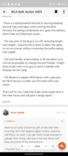

Talked with BCA 12/11/24 they stated next month 6.5 Grendel will be available in the bolt action ar upper soon to follow 308win and 6.5 Creedmoor now what I got from the conversation with the gentleman because I asked about 22arc possibly he stated buy the barrel of your caliber preference and install very easily on the bolt action upper I’m curious about the gas hole on the barrel if anyone has that information please post
Imo a easy lil cash grab for them would be to make some "blind" gas blocks for regular AR barrels shouldn't have hard at all I think...just a regular gas block but no hole...maybe a lil snugger fit

How is Primary extraction?
The 350 for $345 and put another caliber barrel (one that would headspace) is a little much to buy. The Gen 2 straight pull complete upper in 350 legend is on sale from $300 to $225.

The upper probably does not have a hole for the gas tube as that would be a safety issue if some put a gas barrel with tube on the receiver.
