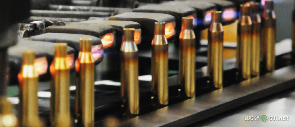

View attachment 1748132 View attachment 1748133
Cannot believe someone agrees with me. It goes on and on forever. Your pix on the right is like I have my flame.
