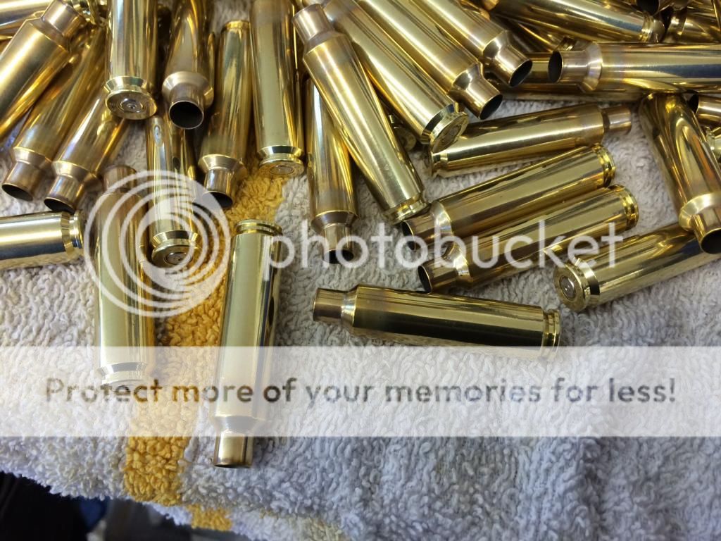

Is this where you have the inner blue flame hit the case? The red straw indicates where on the case the inner flame hits.

Yes, that's a good place. I would do the other one where the shoulder meets the body. It's really not that critical as heat will migrate towards the neck mouth anyway.
