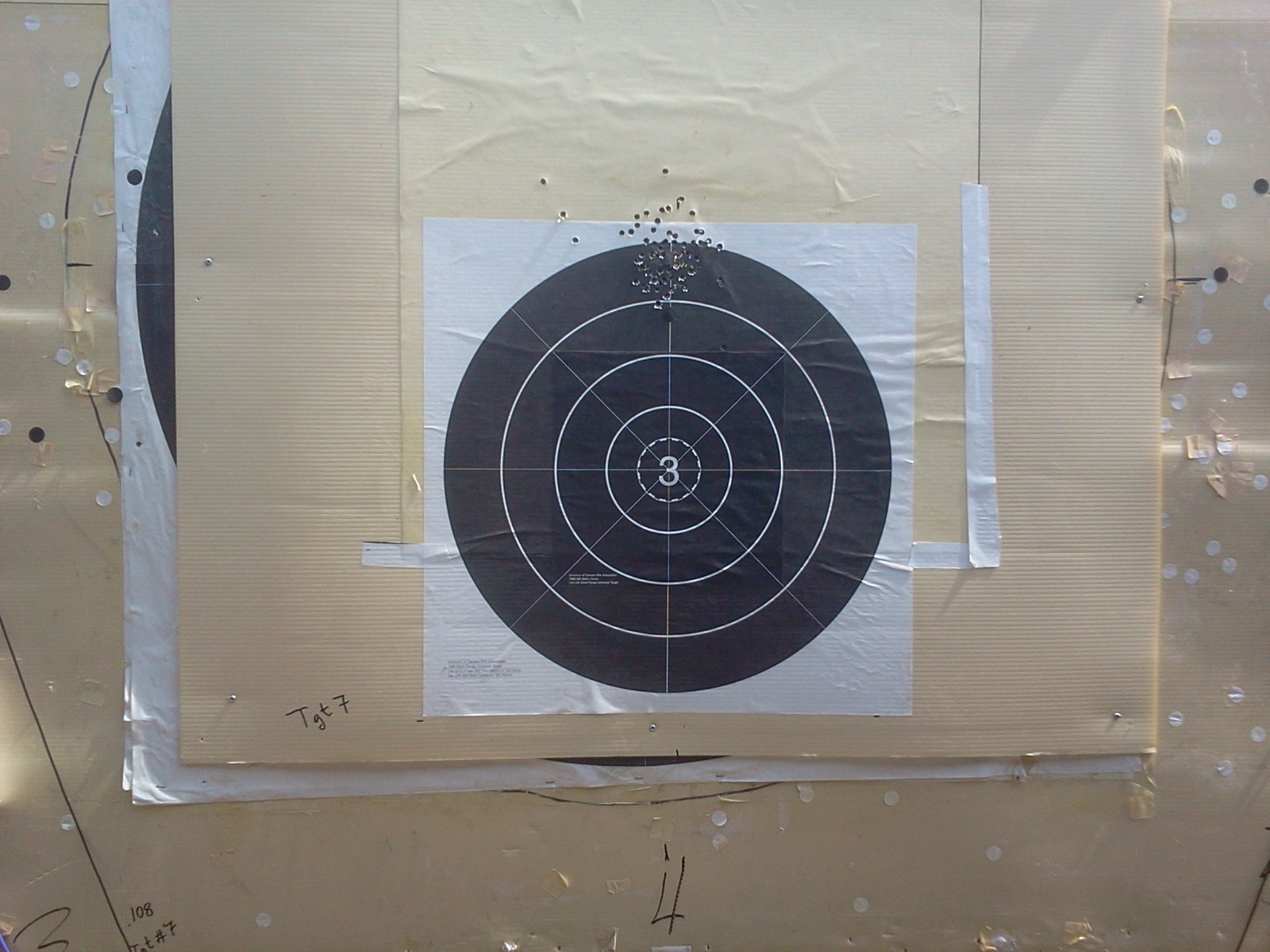

For the LR target, where anything 'on paper' counts as at least a six (for sling), or a five (F-class), the target center needs to be the same as the acoustic center, and pretty close to center. Sometimes the physical paper center isn't always perfectly centered either; anyone who's had the joy of trying to assemble a four-piece LR or MR target face, attempting to line up all the rings given the variations of each segment, and having to then paste a new repair center over *that* just to cover up the mis-matched lines... knows what I'm talking about.
But for something like the MR-63FC or MR-65FC where the center of the target typically gets chewed to shreds, obliterating the center aiming point after only one or two shooters... would it be feasible to *intentionally* offset the center of the e-target, so that the center aiming mark remains intact throughout the day without requiring *any* trips to the pit to re-center the targets? Typically these targets have a wide 'visible miss' band outside the 5 ring due to the nature of their construction; it should be possible to have the entire area described in the rules available while offsetting it say... six inches or so to allow the center to remain visible regardless of how many shooters fire on it.
This is another one of the things that came up during the NRA competitor meeting at the 2015 USA FCNC - how to address the centers getting shot out of the targets for the Mid-Range Nationals, and how often they'd need re-facing.
Just spit-balling an idea here... curious if any of you 'veteran' e-target shooters have seen or done anything like this.

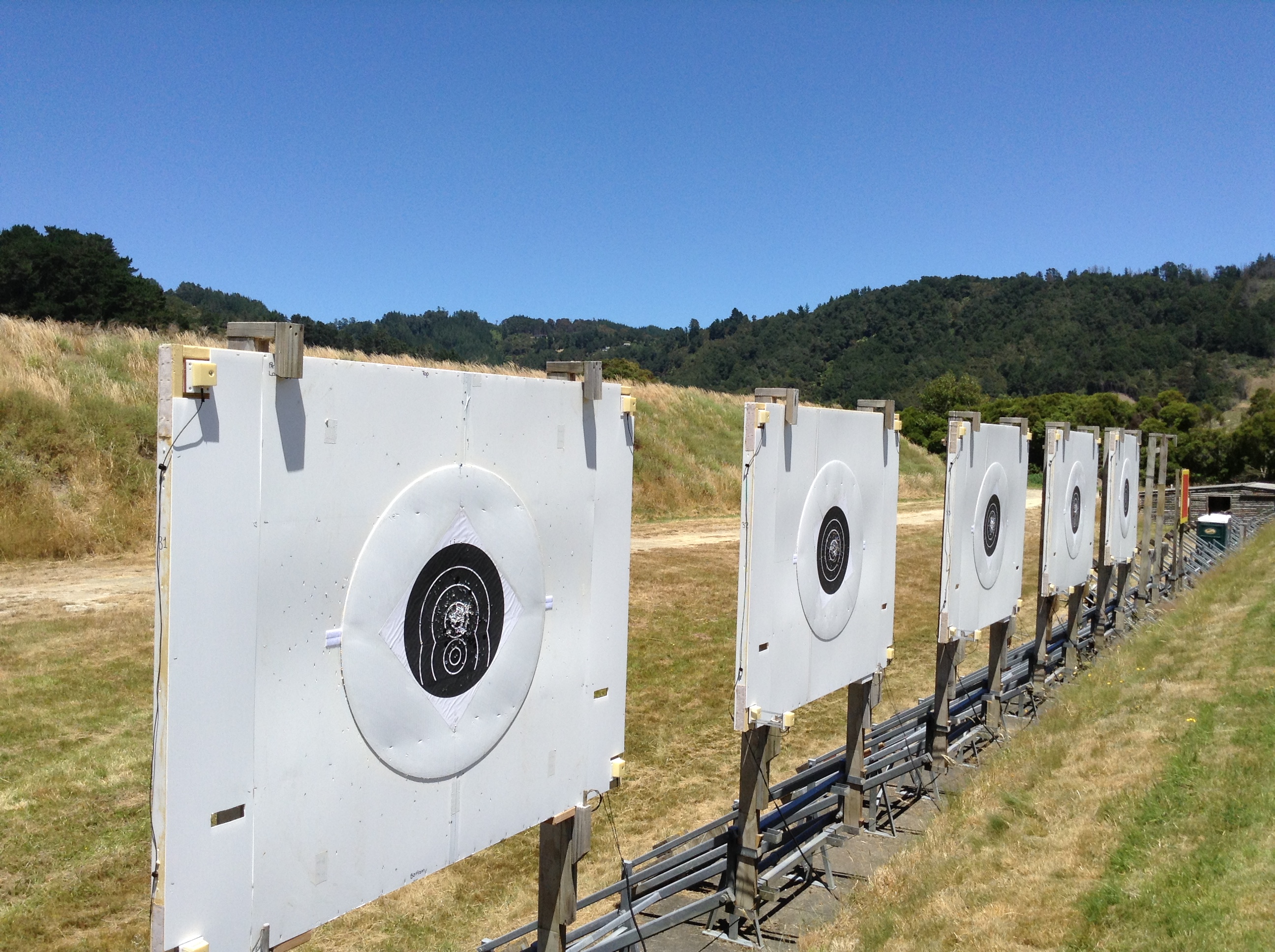

memilanuk, here is what we did in New Brunswick, only at 300m, to avoid getting the target centre shot out and useless to a scope shooter:
In New Zealand they came up with what I think is an ever better solution:

We glue our aiming marks ( different sizes for different ranges) to coreflute then Velcro these to the target. The centre of that also has a replacement on coreflute with Velcro which is replaced as required as the range is contested so all shooters have an equal as we can make it as near new target to shoot on not shot out or patched over.
When I shoot on paper I ask for the smallest spotter they have in the pit as the normal range size can cover the X ring and a sizable amount of the 6 ring making aim off or wind off difficult. The monitor shows this without hindrance instantly. Placement of the monitor so the head dose not leave the rifle to see the monitor is possible.
