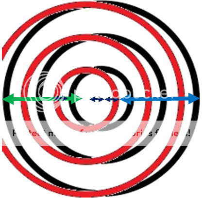

Hi Russel, I have no experience with electronic targets. It is the potential horizontal target offset that causes me concern. Below is a crude attempt to explain why target offset concerns me.
Black is Aiming Target. Red is Acoustic Offset Representation. Green Arrow shows POA-POI for Left to Right Wind. Blue Arrow shows POA-POI in Right to Left Wind Switch. Purple Arrows show how the Effect of the Offset Doubles when you Crossover.
Basically I'm trying to say 1/8 MOA offset could translate into a 1/4 MOA difference in impact when you cross over.

Are you saying that changing wind blowing across an electronic target changes the acoustic center (and hence moves the reported impact point)?
Supposedly it can be, on the targets with external microphones (i.e. SMT). The Hexta literature implies that it is a serious problem; the article by Bryan at the beginning of this thread would seem to indicate otherwise.
Sorry no, what I'm trying to say is if the visual and electronic centres aren't aligned your rifles still air zero will be out compared to the electronic zero.
And if set up haphazardly the acoustic centre versus optical centre will vary from target to target across the range.
Effectively changing your wind zero each time you transition to another target.
Any seasoned competitor knows how critical a proper wind zero is to our sport!

Yes, we at HEX Systems do consider crosswinds a problem with open sensor targets. It magnifies the real windage effect, but consequently the error tends to be masked by it, so it's not so easy to detect. But the fact remains that you don't want the target to be adding variability at all.
The acoustic chamber solves this problem, which is why it has been “conventional” for decades now.
I think that Bryan plays down the importance of the crosswind effect by saying that only crosswinds at the target face will cause it, using the argument that the wave front moves out radially along the surface of the target. This is not correct – in fact the wave approaches the target in a conical shape. So the “boundary layer” effect he describes does not come into play.
