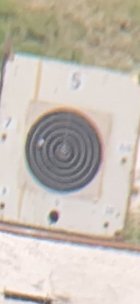

Here is a 300 yard target I shot two years ago. As some rocket scientist will point out, there is some offset but consistant and not enough to change score.
