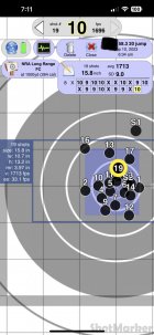

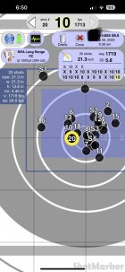

I tested once again at 1000 yards and couldn’t have asked for a better day as far as conditions go.
I will post chrono numbers once I download them but they are very good and compared to the last session.

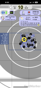

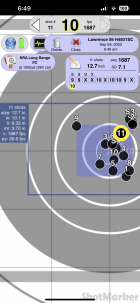

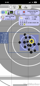

The screen shots show the charge used and powder type. We used fed210 primers, 180 hybrid. My rounds were loaded with .003 jump and my partner used .020 jump.

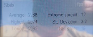

Chrono data:
58.5 (N555) AVG 2966 ES 11.90 SD 3.6
59 (H4831SC) AVG 2935 ES 21.90 SD 5.2

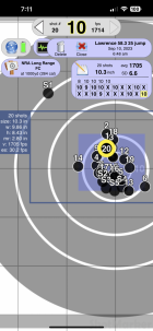

Wrapped up Sunday with some more No turn 7FCP testing at 1000. I used 58.3 of N555 and jumped 180’s (.025”). This data is for 25rds to include cold bore AVG 2963 ES 26.8 SD 5.9. My partner tested with the same charge weight but he slightly neck turned the necks.
I managed a 198-10X, my partner shot a 194-6X and he also shot a 22BR which scored a 197-9X in the same conditions (not bad for a 80.5 bullet).
Results are still not sufficient to even attempt playing at the higher level and is still a work in progress.
Yes sir the 180’s are the ones, really wanted the 190’s to shoot well. They group fine and then get the dreaded flyer out of no where. I have a few more things I’m changing up on my loads 1st of next week. If not back to 180’s. The 190’s hold tight in my straight 284 @ 2770 FPS. I’m pushing the 190’s 2885 in the FCP. Plans are to change up charges and nk tensions and see if it will settle down.
When it’s throws a shot it’s usually high, vertical is really good for 6 to 7 shots then it happens.

Just breaking in the barrel for my new 7FCP I just chambered up, this is only 100yrds but it’s a 20 shot group fire forming. Barrels broke in now, but I’d like the temps to warm up a bit for load development, been in the 30’s and now dropping into the teens to signle digits for highs next week, come on warm weather!
what was your load combo? that's pretty amazing
