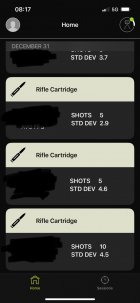

57.3- 2885,2880,2881,2884,2875,2885 100 yard group 5/8", 200 yards 1 1/4"
57.5- 2891,2894,2886,2891,2883,2891 100 yards 1/2" , 200 yards 3/4"
57.7- 2896,2895,2997,2899,2898,2899 100 yards 1/4" , 200 yards 5/8"
57.9- 2901,2907,2915,2909,2913,2919 100 yards 5/8" , 200 yards 7/8"
58.1- 2915,2915,2922 200 yard group 1 1/8" , no visual pressure signs
Just had my KS Arms 8.5 twist barrel spun up. It's finished at 32" and is a 6 groove cut rifled affair. After barrel break in I ran ADI2209 loads (H4350) from 52.5gr up to 53.2gr. I didn't load beyond this as I just wanted to get an initial feel for the barrel. Compared to the Cheetah barrel I had which showed pressure signs at 53.2gr, the KS Arms barrel displayed no such signs, with velocity on the low side at 2835fps with Berger 184gr hybrids. This load produced an ES of 5 and SD of 1.9.
Initial testing was done at an indoor range so now that I know there were no pressure signs, I'll continue to work up a touch higher as the other guys in Australia who have got this case running well have done so around the 2850fps mark. We just don't have access to N555 and RL16/23 which produce more velocity that ADI2209. ADI2213sc bumps up the velocity, but generally speaking loses out on accuracy to ADI2209.
