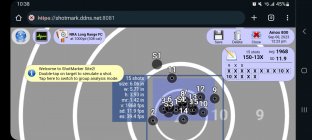

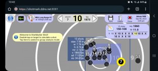

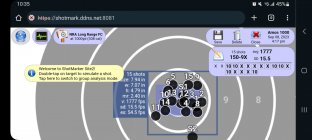

500 yard club match, N555 @ 57.0, 57.2 and 57.4. Not great but interesting, wind was up and down and I never stopped for conditions. Most holds were 1 left to 1 right. last pic is left overs from all three loads held center, go figure.
