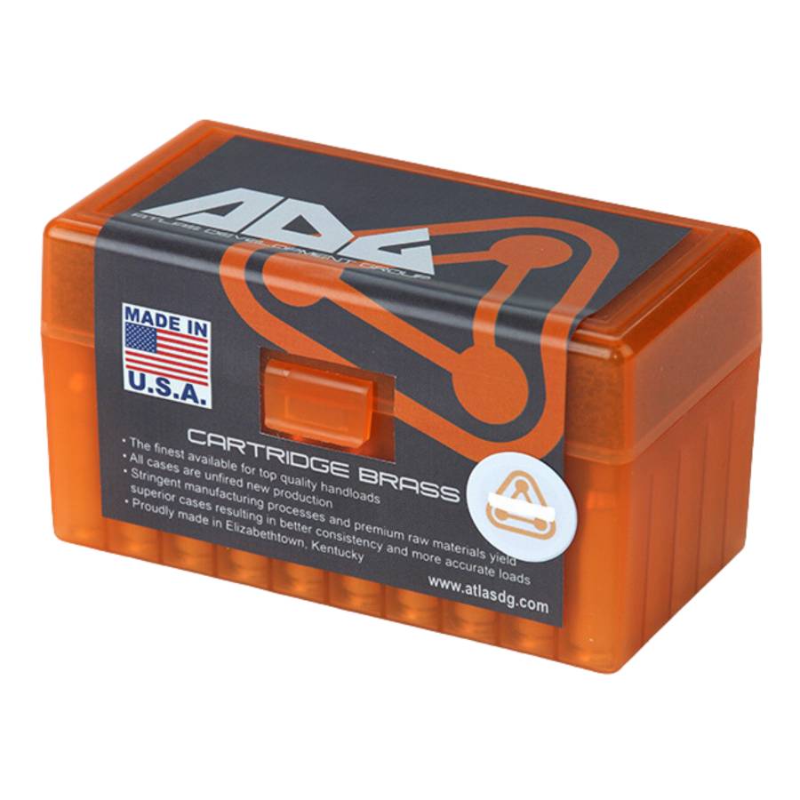

As does Drifter's Gear, just ordered 3 boxes that are now on their way...
Just received a message that my 800 pieces of headstamped ADG 7-6.5 PRC brass will be here early June, I was told it’s going to be necked up to 7mm and ready to load…..
YAHOO !
Please excuse my ignorance on this topic. Are people preferring to neck up lapua brass OR is the ADG 7x6.5PRCW brass preferred???
I haven’t used Lapua for 7-6.5 PRC so I can’t comment. I can say that ADG has performed very well for me through four firings. So final verdict still pending. Zero complaints so far.
In my world Lapua rules.
However im always willing to explore anything new.
This is why I am intrigued. I've been a Lapua guy for my cartridges but now I can't get any for my 6BR and then Lapua doesn't make brass for my 7 SAUM so I've shot a lot of ADG. I think both both make good brass. I'm considering a switch down the road to the 7/6.5 PRCW and am trying to find if a particular brass is the no brainer or if it's 6's.
My gunsmith and I used a no turn neck reamer for our builds and I have used Lapua 6.5 PRC brass necked up with great success so far, I use the Eric Cortina Body Die Mandrel with the .282" mandrel.
I do have a bunch of the ADG brass coming, nice to have proper headstamped brass as I will have 3 rifles chambered in 7-6.5 PRC
Ive used both Lapua and ADG brass in several cartridges and both are excellent
