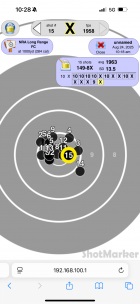

Actually , I dropped the powder and got a good waterline prior to this match. Nobody else had verticals , not even the 6’s . As it got dirty it tightened up . This was a mullerworks barrel which I have never used before. It has shot really well but at 1100 rds speed fell off 50 fps in 90+ degree heat . I shoot it 2880 fps and have no clickers. I put another mullerworks on it since this one shot well . I will put it to work this weekend in St Louis.davew2.png

I think your vertical is your rear bag setteling. your rifles bouncing on recoil,
at least it looks a lot like it....id check that if it was my set up...ask me how i know.
I’ll find out tomorrow. I put 50 rds down the new barrel and no vertical on it doing charge testing . I am shooting a new Edgewood original rear bag . my old Protector the palm swell would hit the ears if I didn’t set it with recoil pad barely protruding . I always seat the gun in front and rear bags if I take it out of the rest. This is the only gun I shoot out of this setup .
On a personal level , I am defending Big Piney open champ and can take it again this year . The new barrel was ready to screw on and took the same load as old one in testing. My next barrel I will swap to Krieger which is my preferred brand and compare barrel life. I chose this brand when I swapped from 6 dasher strictly due to availability.
This is testing on new barrel holding X for a waterline. First shots were adjusting scope after being off the gun .
Thanks for your insight about the bag . It is new so I won’t dismiss it especially if it continues to throw verticals.
Must have been the barrel . Shot in St Louis today and no verticals .

600 yds . They don’t do convertibles in St. Louis. We do do them at my home range on electronic targets. The 2 I dropped was all me . First one was scope adjustment and second one a gust caught me.
My daughter 7 prc-w today at Idaho state 2day regional match in Rexburg. Shot the Palma course she ended up finishing 3rd in F/O.
800yds
150-7x
900yds
149-8x
1000yds
149-10x
Switched too n555.
55.6gr of n555
White River LR primers
ADG brass
180 hybrid
Bto 2.430
