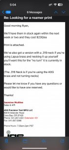

I'm not sure about her barrel but that's what mine is to the best of my knowledge. I'm fairly new to this and I'm learning. Just so I don't tell you wrong here is the reamer print
That is the Neck Turn reamer print, the NO Turn print has a 0.3190” neck.
Also the print has the designation of NT -No Turn
You may need to turn your necks, at least a skin turn. My ADG brass came out of the box with about the same neck thickness as Lapua, and my chamber is a .315" neck. I turn to .310" loaded round neck diameter for comfortable clearance.
Entirely possible this is contributing to elevated pressures and sacked primer pockets. Peterson brass is thinner in the neck. You may be able to load that without turning, but I'd be sure to measure first.
according to JGS the .319 is for no neck turn for necked up lapua brass and the .316 is for no turn when using ADG brass.
I just measured loaded ADG brass that is on its first load as well as ones that are on the 11th load and it was consistently .311-.3115. I honestly have no clue as this is my first reamer and upper end barrel. I am curious as to what effect turning the necks would do. I may have to test it. Y'all know way more than me so please correct me if I'm wrong, I do want to learn more. I started f-open last summer with an off the shelf Aero Precision 22" 6.5 Creedmoor so I'm really new to all this.
I used the same reamer as EricCu and this is what jgs told my buddy. .316 neck is for ADG brass.
I’ve been using the ADG in my 316 neck about 8 months now .I also get .311” loaded neck . When I turn necks I shoot for .004 clearance .i get that with the ADG out of the box.

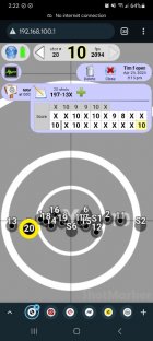

My buddy shot my daughter’s rifle this is how it did at 600yds last Friday. It was pretty windy with a hard wind coming off the mountains. I use H4831 in her rifle.
