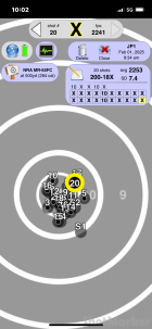

Wanted to circle back with an update. I'm running 32" Krieger 8.5 twist barrels chambered up by Alex with his reamer, .319 No turn necks w/ neck turned Lapua. I'm on the second barrel now. I originally started off with around 53 Grains H4350 and it shoots well but pressures up quicker. 55.0 Grains of N555 has been the easy button with 180 Hybrids in both barrels (2895-2900 fps) and w/ 1200 rounds on this barrel have not had to move the seating depth. Started with a light .012 jam. I planned to shoot one more match and spin on a new barrel but it shot so well I'm going to shoot one more with it. I've always found these barrels like to be a little dirty and I'll foul in with 50 rounds during a practice session the day before. ( I'll post a picture of the first relay on Saturday after 50 foulers: 200-18X ) I use this day to test my tuner settings also and find any adjustments to be very small if any. This is a very forgiving cartridge that just does what it's supposed to so you can focus on strategy and reading the conditions. Had a great time and pulled off another win at our local CTSA Mid- Range club match last weekend. We all had a special treat when Speedy was there with Bret Solomon and made a little video of Brets new rifle w/ some footage from the match at the end...
