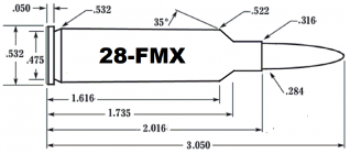

I just finalized a JGS print for this based on Wheeler's public 6.5 PRC print.
- .3155 neck diameter
- .2848 freebore diameter
- .2400 freebore length
If anyone wants it, send me a PM. I placed an order for it, so if someone see's this in the next 16 weeks you can probably get your reamer a little sooner as they'll batch it with mine.
(I have one drawn up for Manson too, if that's your thing)
Whatever the 7-6.5PRC is we need to get a standard design set up that is fire formed from 6.5PRC Lapua Brass across the board. I'd recommend a 35 Degree shoulder but honestly think it's going to be F-Class shooters who decide. I can dream up any diagram, but only the competition shooters will define a lasting Cartridge based on Brass life through development and capacity./just threw a fake in for grins "28-F" not PRC.
When playing with Brass and moving up a size in Calibers, theoretically it's best to increase the Shoulder Angle. In this instance the 6.5-PRC is 30 Degrees so usually 32-35 Degrees is adequate. Why? To eliminate the possibility of Donuts, you need to raise the shoulder & neck Junction. When doing this you raise the shoulder slightly and shorten the overall length of the Brass. The PRC line of Cartridges is already "Improved" my design only seeks to lessen the likelihood of Donuts and increase brass life, it's purpose is not to increase case capacity. Also by changing the name of the Cartridge to 28F is eliminates the confusion as to what the Cartridge is. 284 Caliber for "F-Class" shooting. My illustration is merely a rough draft of course, but it's based on experience. This is not meant as a SAUM replacement, merely a better mousetrap. Cheers!

From talking with a couple shooters that have several reloads on their brass. The neck angle of 30 deg or 35 deg makes little difference to alleviate the donuts. Its like the 6.5x284 Lapua brass we used to neck up.
Same story here. Just seat your bullets above the donuts and you are good.
Same story here. Just seat your bullets above the donuts and your good.
Yep, exactly...
When you Neck up from .264" to .284 the base of the Neck moves down in the Case, this creates a Donut. By changing the shoulder location further up and changing the shoulder angle to 35 degrees you literally move brass (where the Donut is) down into the Shoulder. This eliminates the area in the neck where the Donut would be, "Poof" it's vanished into the Shoulder.
Nope. I run 35 and still have a killer donut.
