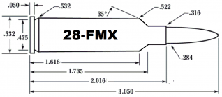

Whatever the 7-6.5PRC is we need to get a standard design set up that is fire formed from 6.5PRC Lapua Brass across the board. I'd recommend a 35 Degree shoulder but honestly think it's going to be F-Class shooters who decide. I can dream up any diagram, but only the competition shooters will define a lasting Cartridge based on Brass life through development and capacity./just threw a fake in for grins "28-F" not PRC.
