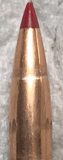

They come from the factory with an OD of .2694. Leaving them at that and seating a bullet changes the OD to .2710. So in theory, I'm not running a lot of tension. In practice, its a lot of tension. (see signature)
Causes not only variable seating depth results but this cup ring:
FWIW, the cup isn't skewed in the die, I took the picture a little off kilter. That ring, believe it or not, gets worse if I make repeated passes to try to get the bullet down into the case a little further. I can certainly expand the new necks a little bit and resize a little bigger than .2694.
I'm not looking for more work but do precision shooters lap their seating stem cup to more closely match their bullet profile, as a means of distributing the force bearing surface over a greater area? Forster doesn't give you a choice of cup profiles.

your just a smidge tight you may want to get the K&M expander they also have ground mandrels in .0005 increments I think, I know somebody does, but don't you have a lathe you can do that yourself, the new peterson brass I use the mandrel to expand the new brass then I load of course after I trim ect, you may want to go in and cham your seat cup also to get a longer bearing surface to match the profile of the bullet, does this make sense, you need to go .242 ID on the case mouth prolly 272 on the outside would be good EDIT I'm at .243 maybe 242 inside and 273 or 4 outtide, the peterson brass is almost perfect to shoot deprime, load and shoot without sizing my neck thickness on 25 measured cases was .014 to .0142 pretty dam good I could not believe it

Thanks for the actionable intel Steve. A little good advice goes a long way with me. Lack of it in this caliber has relegated me to throwing ideas at the wall and seeing if they stick. I'd venture that my necks, as I've been using them up to now, are more than a smidge tight. I will give that a try. Yes, I do have a lathe downstairs and a nicer one at work, for those times that we need to fabricate parts we can't afford to wait for. Gotta keep the 911 dispatch center running 24/7. With groups like you reported, I'd be pleased as punch!

The seating stem cup lapped out easier than I though it would. Contacts the ELD/VLD bullets I have, over an area of about 3/16 inch now, as opposed to the thin line it used to. 2 grits of Clover compound and 4 (un-dented) bullets from the pulled pile was all it took. Look forward to giving it a try. Too late to start in tonight. 04:30 gives no quarter.
