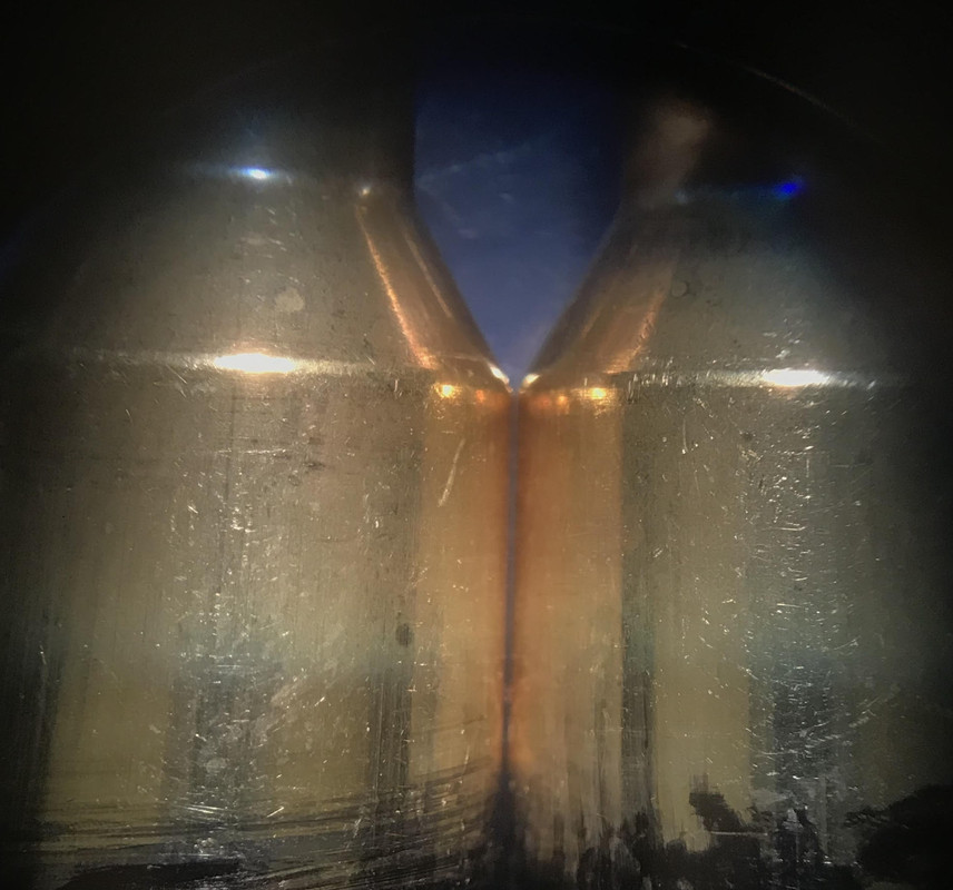

Back from aroma therapy in the great outdoors. Here's what I learned. Coating your rounds with sharpie ink reduces hard bolt lift. ;)
Must have some lubricating property. Notice I didn't say eliminates unfortunately.
After careful insertion and extraction, the only place where it was disturbed was right at the case body to shoulder transition area. Not sure what to makes from these tea leaves. Probably most impressed with the fact that the ink was totally undisturbed up and down the case after such a violent reaction. Three shots at an abandoned target (not a bad group for elbow shooting) and all three looked like this:
I only coated it up into the shoulder area. The color is a little washed out after cropping, shrinking and hosting. The bare spots are much more shiny and brilliant.

For point of clarification. Putting marking compound on brass that traveled by surface carrier, all packed together in a plastic bag, tends to amplify the individual dings they incur along the way. The marked up case image I posted earlier is no different. I took a look at two of them under the stereo microscope at work with the marking compound removed and they are indicative of 1-fired Peterson brass I have seen countless times before from this chamber. Unfortunately, someone else had the scope camera checked out and I was forced to capture this image with a smart phone.
While you do not have the benefit of a stereo view's perspective, it should be apparent that what appeared to be a secondary ring at the shoulder corner or a rough engraving, was the result of a poor choice of images.
While it is true that my empties bind in the chamber at that junction and you can kinda see the shined spots left behind when they are extracted against their will, (look where the two shoulders touch), I don't believe that binding is the result of surface imperfection in the chamber. Close study of it with a borescope shows a fairly clean and shiny job at the corner where the straight wall meets the shoulder. Keep in mind that I've only put about 150 rounds through it so any polishing of the chamber wall from the cases having to be yanked free at the bind spot (steel vs brass) is not readily apparent yet. Actually the entire chamber looks like you could comb your hair in its reflection. Makes it hard to assess with the borescope light reflecting back in my eye but I'm just not seeing any irregularities in the cut job there.
