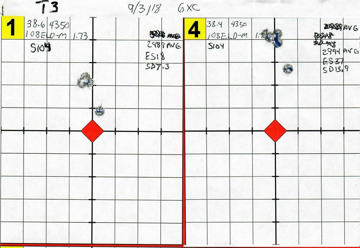

I'm not looking to improve as much as get consistency from one reloading session to the next.
Here's some typical results, albeit a slight difference in charge weight. I shoot 22 ARA Rimfire competition as well as centerfire. IE I get the importance of bench discipline for consistency. I have a very nice, micro-adjustable front rest and several diferent rear bags. I also have a 1-piece Pappas rest but have not tried it for load testing as I enjoy feeling like I'm shooting, not operating a machine.
The one limitation at the Sportsmen's Club about 8 minutes from my house (I'm the rifle range coordinator) is it only goes out to 100 yds. Nice stable concrete tables though. So I strive for the smallest groups possible at that distance as a metric, along with good velocity SD's.
Here's what bugs me. Two 5-shot 100 yd strings. This was with new brass that only had their primer pockets normalized and the mouths deburred. The grid is 1/2 inch. No the 38.4 didn't shoot higher. I dialed the scope up to get the impacts further away from my aim point.
Always with the one stringer and out by more than I would expect at 100 yds, given the POI of the other shots. Not choke. They came somewhere in the middle of the strings. FWIW, 1.73 is just kissing the rifling. I tried +.005 and the neither the groups nor the SD's improved. Have not tried setting them back yet. 3 hours once every Saturday does not afford a lot of shooting opportunity for a working stiff with homeowner chores and two cars to keep happy. The brass and Rem 7 1/2's liked 38.6 H4350 that time out. Have been meaning to get some CCI 450's but have a lot of the 7 1/2's. They seemed to do well in Salazar's article a few years back. Got out several times since that range day with processed 1-fired brass and the results were not nerly as consistent. That's what I'm trying to get resolved before the temps get any colder. Still got a weekend or two left to experiment.
I realize that I'm a relative newcomer to this caliber, with a lot of experience base building needed. Already looking forward to the return of comfortable shooting weather in 6 months.
Lest I forget. The wet tumbled brass is drying in the oven as I write this. Looks like I will be wet tumbling the rest of it as the necks indsides are much nicer on the couple I quickly looked at. Love the chips I just got to try instead of pins. Much faster tumble times. Not sure is that will cure my bullets scraping off in the necks. I could shot plate them. I have MoS, WS2 and HBN at my disposal. Do you guys dust the inside of your necks with dry lube on a q-tip? Open to suggestions!
Did I mention that I'm windy like this on all the forums? :rolleyes:

For 100 yards the SD does not really matter, velocity variation does not cause the fliers you have. I doubt that’s the brass also, it all went through the same process, how could it cause fliers out of good groups? Five shot groups are better than 3 shots, but more is needed to get the story. Remington 7 1/2 BRs have worked well for me in 223 at 600, again, not the reason for the fliers. Seating close to the lands is asking for trouble in my mind, either contact positively or be well off. Is this a VLD bullet?
Try 105 Berger Hybrids or the 107 Sierras and keep them off the lands.

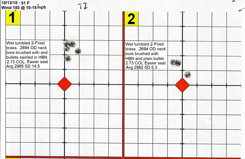

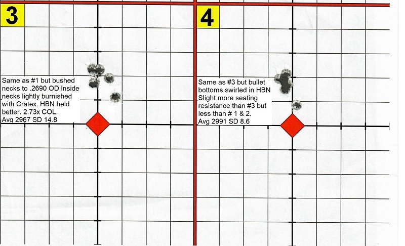

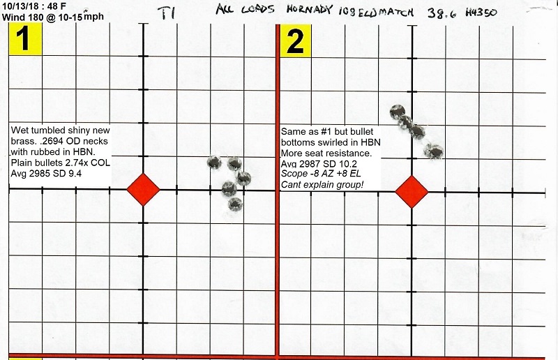

Sorry to be so late getting these up. Better half lured me to LR to see new Ron White's new comedy routine. Kept hoping it would be as good as his earlier work. Unfortunately a little ho-hum.
A note to explain varying COL's: The seating resistance really fought me getting consistent COL's without changing the die setting, which I didn't want to do. Serious seating cup rings as it was until last two groups.
Here they are. Hope you can read the annotations.
T2-2 was my best 5-shot group and my worst disappointment when shot #4 went low right. Again with the stringers!
Hoping for a couple more Saturdays of tolerable weather (I'm a cold weeny in the wrong state). Since I'm addicted to the look of wet tumbled brass, I will add brushing the inside of the necks with a 22 cal bore brush built up with 0000 steel wool. First some plain bullets and maybe some shot plated HBN ones. I'm assuming I'll have to adjust the charge to get the velocity back up. If that's all the extra steps it takes to get good results with these Hornady 108gr ELD Match bullets, so be it. Next spring I'll try some other ELD/VLD style bullets. The Sierra 95gr Tipped Match Kings showed some promise in my 1:8 twist barrel a few weeks back. Just did a couple test groups to see how they flew. There is merit in the advice to try the 108's back off the lands as well. Too bad the blems at Midway are all sold out. Should have gotten more than 1 extra box. Need more O.T. to support my habit. ;)

Looking at your targets I’m pretty sure that the fliers are not ammunition related. There is no chance that all fliers from ammunition all would go out at 5.30.
I would mostly agree. Most of the time when you see consistent shots out of good groups it is shooter related. BUT sometimes it could be something weird.
I would say several groups have a bug hole with a shot out. When ever I do that, I load 25 of the same load and go shoot five five shot groups and see what I got. was that shot lost to conditions, operator ect.. Now sometimes when you are seeing something like this and it is not the shooter. It is the bullet. Shoot another bullet. Berger 105 HVLD is one I could recommend and if the one shot that is always out goes away its them Hoaky Hornady bullets that have been coming apart. If you print the same groups with the Berger bullet I would look hard at yourself and bench set up.
I once had a freeky accurate 6XC 1-7 twist and I keep loosing shots horizontally at longer ranges and most would say wind ect. but I noticed it was always the same way and the wind did not cause it on some shots for sure. So I talked to a few guys who knew I was serious and it was not the wind and they instructed me that the vertical grip on my rifle and thumb hole stocks are known to cause unwanted horizontal so I changed how I was shooting the rifle and the problem went away. Now if it was out I call the wind did it.
