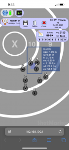

28" Kreiger, 1:7.0 tw, .150 fb, .237, 4 gr, 1.25 str
Virgin Lapua brass, BR-4, all jammed a little bit. came with .267 neck, i left it
red is areas of interest
forgot to get the tgt info on 107
ALL --- vv N150
HOT day in south Louisiana
107 smk103 VTAC110 smk115 dtac
N150FPSN150FPSN150FPS
N150FPS33.2 gr294832.2 gr282932. 0 gr2775
33.2 gr2909224328152778
291033.5294132.4283132.22780
33.52922295428292780
293633.7296732.6284232.42782
33.72934296228442789
294633.9297932.8285132.62816
33.9295529842849
295734.1299733285632.82828
34.12958299828292818
296534.3301333.22871332826
34.32975300028822846
297734.5301733.4288533.22847
34.52987301828912831
297634.7303433.6201933.42856
34.72994303328822857
299234.9304733.8290033.62885
34.93011303929102859
301235.1 gr305634 gr292633.8 gr2868
35.13017305929232875
3023
110's seem to like a slight jam
37.4 gr H4350, Lapua brass, 205m, 267 bu. 110 smk +3 = 3020 avg fps
28" mueller, .236 bore, ,120 fb
600 yds e target
---shots 4,5,6 (37.2gr and 3000fps avg) had a 2.0 sd, but shot 6 had a stiff bolt close(brass not bumped or sized enough) and it spit it.....anyway....
no sorting of primers or bullets
also did 37.3 gr at +10 ITL and it was 1.58" 3 shot group at 3015 fps avg
balmy/humid 77F near sea level
f class rifle, nuevo action, Old Dominion bedded/chamber/ etc.
