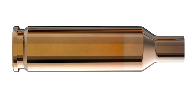

The 6GT was formed initially from 6.5x47L. The size of the cartridge is between a Dasher and 6x47L.
Left to Right
Dasher - 6GT - 6x47L
Water Capacity of the 6GT made from 6.5x47 is 43.3gn
