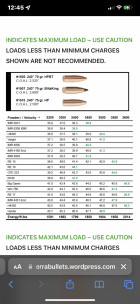

Any thoughts or experience on loading a 6mmGT with a 6mm 70gr SIerra BlitzKing for varmint hunting? Sierra data shows 48.3 of H4350 as max (6 Creedmoor data). I have a 26” Bartlein 1:7.5 MTU contour chambered in 6mmGT.
Thanks, Jim
Thanks, Jim
Not sure why you referenced Creedmoor data, but that would be a no no.
Have a look at N135 and H4895 for the 70s in 6 GT. N135 is pretty easy to get right now.
