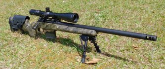

I had a spare Savage model 10 collecting dust. It was originally a 6.5 Creedmoor that I had pretty much considered shot out (~3k rounds) accuracy was waning and speed slowing down a bit. So I decided to rebarrel to 6.5 Grendel. Ive been hung up on these short little super efficient cartridges lately.
Conversion was simple. Just swapped bolt heads to a ppc / 7.62x39 diameter bolt face. 24$ part. Shopped around for prefit barrels, but no body I found offered them in a Grendel. Finally came across Shaw barrels.
Not wanting to invest too much into this project, I took a chance on one of the carbon steel barrels. Had them spin up a 1" bull barrel 22" long cut for savage threads.
Already had a NSS barrel nut and recoil lug.
So I was into this project a grand total of about 240$ for the barrel and bolt head.
I couldn't be happier with the results.
Super accurate. Can push a bit hotter than gas gun data. Very mild recoil. One of my favorite rifles to take out and target shoot.
If I had to do it again I would probably go a bit lighter profile barrel so taking it in the woods wouldn't be a chore. But overall very happy.

Have since had the muzzle threaded and Cerakoted everything. Not sure I'm digging the cheek riser yet. Just put that in there
