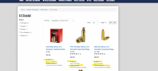

6.5 Grendel
Looks like primarily an AR-15 load guide. I don't currently have an AR-15 in the 6.5 Grendel.
I think what he is trying to say that there is a lot of loading data in these books for the 6.5 Grendel. The data is for AR’s but can generally be used in a bolt action but you can go higher in a bolt gun on pressure but also hence the disclaimer “start low and work up”. But, then again, I’m not speaking for anyone but myself….
You can find data for the Grendel online for Nosler Bullets too. Do a search for Nosler Reloading Data and they will give you powder options and starting points
I think what he is trying to say that there is a lot of loading data in these books for the 6.5 Grendel. The data is for AR’s but can generally be used in a bolt action but you can go higher in a bolt gun on pressure but also hence the disclaimer “start low and work up”. But, then again, I’m not speaking for anyone but myself…. You can find data for the Grendel online for Nosler Bullets too. Do a search for Nosler Reloading Data and they will give you powder options and starting points

Perhaps look at 65Grendel.com for extensive list of loads, etc Thanks Rich
Anybody have 100 rounds of grendel brass they'd like to part with ? Used is fine. Like to use some used brass for load work.
