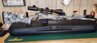

6.5 Grendel
Stock arrived from Stockys. Needed some barrel inletting due to contact at the fore end where the barrel extends. I think the Stockys are cut for the Sporter barrel. Not sure why they ask which barrel profile your ordering for when they need inletting regardless. Stock weighed 20oz as advertised. Complete rifle with scope comes in at exactly 7lbs loaded with 6 rounds. Very light.
Which stock profile is that one? Also, how long did it take for stocky's to get it to you?
Stock profile meaning barrel channel ? Design wise it's the vertical grip stock that looks much like the Iota Eko or Kremlin but the fore end is slimmed down to almost a Sporter size to keep weight down. Doesn't have the flat fore arm even tho I have the heavier barrel. Scale weight is 17.9oz. Claimed 20oz was the stock weight from the factory.
