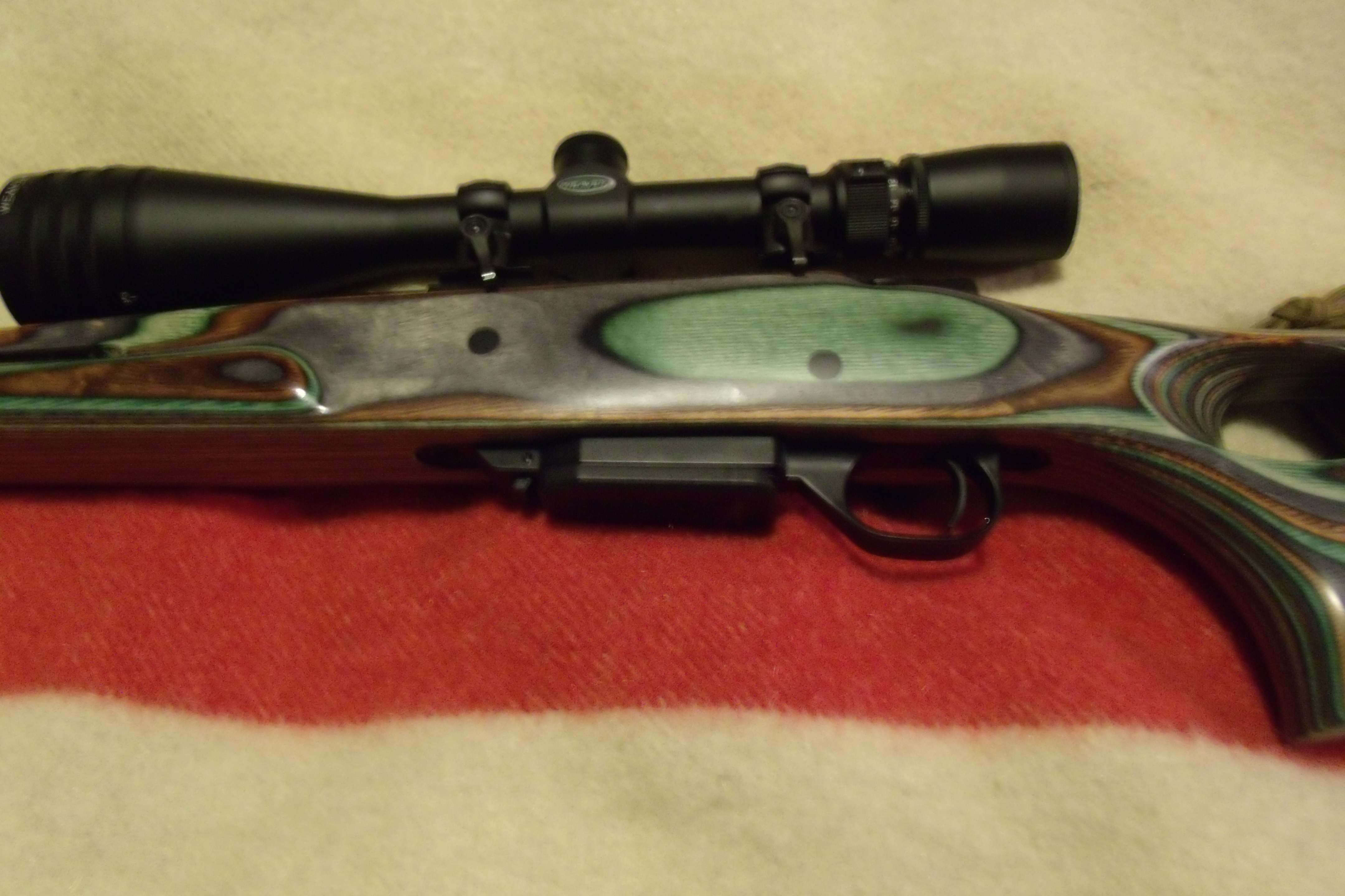

Built this one for a deer or hog stalking rifle. Cheap Lee dies, 3x9 old Red field, AR Comp and Barnes 100 TTSX it has shot 1 1/4 at 300 yards. Go figure.
