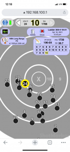

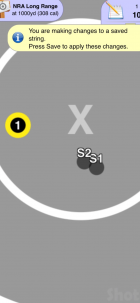

To begin with I want to thank Alex and Sam for sharing their reamer designs and to all of those that have contributed data and information to this thread. Based on these designs I spec'd a reamer and had an F-Class gun chambered for a 300 SAUM Imp. I am using 7 SAUM ADG brass necked up to 30 cal. The barrel is a straight 1.25 Krieger with 9 twist. After fire forming I began load development with 215 Berger Hybrid/H-4350/CCI 250's. I ran a rough ladder @ 955 yards (cuz that is all I could get) starting with 59.6 grains through 62.4 grains in 0.4 grain increments. These loads were jumped 0.020. It was somewhat windy for this effort, 7-12 mph and very variable (moving around a good bit) but was a comfortable 72 F. BTW I am in South Louisiana so just above sea level. I fired 3 shots at each charge as follows:
-Shots 1-3 (59.6)--Avg MV-2793fps
-Shots 4-6 (60.0)--Avg MV-2816
-Shots 7-9 (60.4)--Avg MV-2829
-Shots 10-12 (60.8)--Avg MV-2852
-Shots 13-15 (61.2)--Avg MV-2871
-Shots 16-18 (61.6)--Avg MV-2887
-Shots 19-21 (62.0)--Avg MV-2909 (excluding Shot 21)
-Shots 22-24 (62.4)--Avg MV-2920
Overall, looks like merging @ 62 and 62.4. I enlarged the screenshot from ShotMarker so Shots 1, 3, and 6 are off the screen. However, Shot 1 in the top of the 6 Ring below Shot 2 and very slightly left. Shot 3 located in 6 Ring in the center and 6 is located at the bottom of the 7 Ring in the center. Shot 21 had an abnormally low MV based on LabRadar and also at Target using ShotMarker data. Later I loaded and shot 3 rounds charged with 62.2 grains with everything else the same. The second pic illustrates those shots. Am planning to do another ladder test to confirm and will work on seating depth after that.
