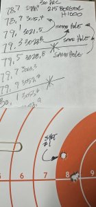

This is a ladder I shot with my 300 PRC (AW2 Reamer) with 215 Bergers and H1000.
This target is first five shots.
There is another flat spot at 80 grains but why go hotter for 25 fps.
Nice window all in the same hole with 4 different powder charges.
I have Garmin chrono readings if needed.
Bat Tactical Elite Action. Bartlein HV 1:9 Twist. Sandman Long Suppressor
Side Note: 79.8 grains (between 79.7 and 79.9) is where I would usually begin at where I have an ”anomaly” and a flat spot.
“Anomaly” being higher velocity (3063 FPS) with .2 of a grain less powder.

This thread is for the 300 NI 35 degree. This post needs moved.
