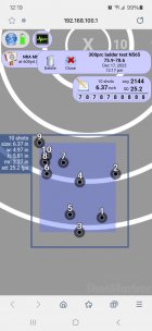

I finally got around to shoot it today. I put 5 sighters down the tube, loaded to 75.9gr N565 with a Berger 230 (roughly .010 off of lands). Then I did two ladder test at 600 yards (N565 and N570)
This round did not disappoint!
First ladder test was with N565, CCI 200, 230 Berger, new Lapua brass. Shot @ 600 yards. The powder charges and velocities for respective shots are below.
1. 75.9 - 2828
2. 76.2 - 2824
3. 76.5 - 2844
4. 76.8 - 2863
5. 77.1 - 2852
6. 77.4 - 2883
7. 77.7 - 2894
8. 78.0 - 2885
9. 78.3 - 2909
10. 78.7 - 2916
I'm going to keep going up in charge weight. I think there might be something around 2940-2960.
