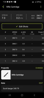

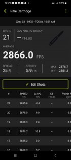

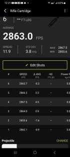

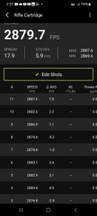

I put my other barrel on that is throated for the berger 245s oal is 3.750. 30 inch bartlein n565 I know it's slow but been shooting lights out. The few bullets that are off a little are mostly from me. Adjusting to the recoil of the 245s vs 220s in a supressor was different and the barrel isn't as heavy. Good news is I finally figured out my issue. Embarrassing but it was a sizing issue because my so called .02 shoulder bump wasn't .02. My SAC headspace tool doesn't go down to shoulder and was throwing my numbers off. I thought I did Alex Wheeler method but I guess I didn't and messed that up. So my brass number at 2.0445 has a slight drag tap with finger to close easy with plunger out of bolt. I sized it to 2.044 and it closed on its self from there I took .02 off and got my true shoulder bump and have tested it with good results. I wasn't getting any shoulder bump so the brass had nowhere to grow. It was a foolish mistake but learned a lot with these tools DONT TRUST them do it Alex way and it's fool proof. I thank for all the advice. @Ledd Slinger you asked if I used the method and thought I did but I messed up thank you for info and advice.
I think someone else mentioned using Alex's method so i cant take that credit ;) Glad you got that part figured out tho! Still doesn't resolve the lack of speed. Would love to see what those barrels will do with some N570 or H50bmg
I agree for now I'm prolly going to run this load for the match then I'm gonna do more experiments with powder. But fighting all this and time components ect. I'm content for now. The load is very impressive for match setting but I have my eye on n568 and n570 for sure.
Yeah I should be way faster I didn't push it once I fixed the issue I shot this load and it just stopped. Maybe little break is needed I've been at it for a bit trying to fix this.
