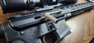

I disagree, they can be great PD guns, once converted to manual. No buffer/buffer spring and trim the ejector spring a little. No brass damage, stays clean and the brass piles up right next to you.
On our way back from ND now. Will be converting to 20 Practical for next year.
