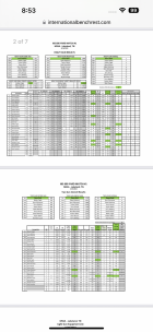

Been awhile since I posted..
I continued to shoot my 20BRAI in competition that yr.. here’s how that match faired out…
I carried that barrel to every match that yr, “just in case” senerio …
I shot it at the Mssa possum Hollow matches, won my share of small groups & 1st…
