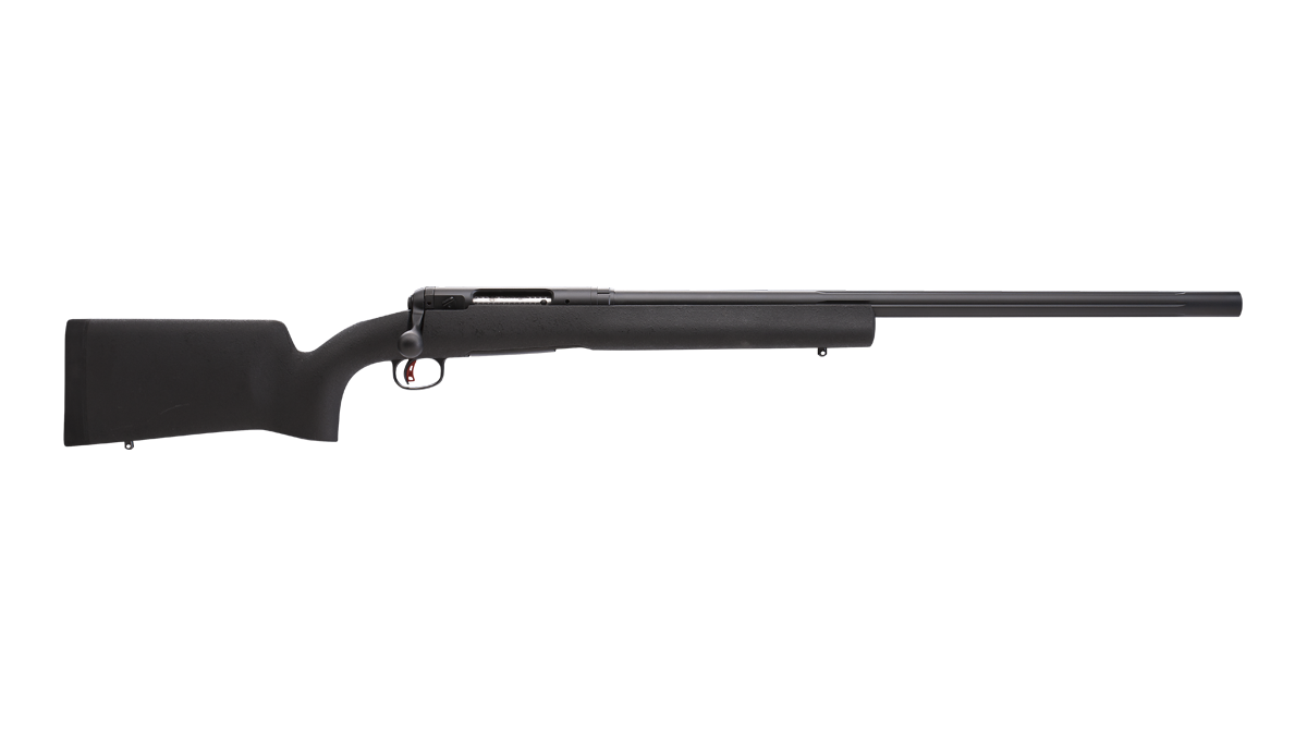

I am looking for some information on the Savage LRPV. I recently picked up an HS stock for this model(single shot-no mag well).
My question is, what factory part is used for a sled or follower and the factory gun to guide the bullet into the chamber. I shoot in production class so it is necessary to find the actual savage part or parts.
The parts diagrams I've checked so far do not show the parts I need for this model.
Savage wants a serial number to look this up which I do not have since I will be putting a different barreled(VLP)action in the stock.

The single shot stock you have was made for a solid bottom single shot action. I'm not aware of any Savage factory made single shot adapter for a repeater action. There are aftermarket ones as I'm sure you are aware. Savage repeating rifles had a magazine spring and follower which worked well for feeding. You may have to cut out a magazine well or trade the stock off for one with a blind mag well and use the factory follower and spring. That also involves a magazine housing, of which they made a couple of, depending on how the action was machined.
My LRPV is single shot solid bottom to the action but I have had Savage BVSS that would load from the top and bought another expecting the same thing and it was a jerry Rigged from the factory single shot with an internal mag that you could not depress and load it was the sorriest excuse of a leftover parts bin deal you have ever seen--It looked like you could load it but was frozen so just the lips to lay a round on and hope it would load--I yanked all that out and put in a sled--I worked with Savage to order the same parts that were in my other rifle and they sent wrong stuff twice so I gave up
LRPV should be solid Post a photo I have some Savage mag parts on hand that may work
This is a guess on my part but if you have a repeater you should have gotten a stock for a repeater with a blind magazine well then purchased a single shot sled that inserts into the magwell. I could be wrong but that is what I am doing. No it is not a Savage part.
savage did in fact make a lrpv repeater I have one, in 6mmbr norma 12 twist, flush 3 round removable magazine with metal surround nice shooting gun they make after market single shot sled which i have in mine
That’s new news to me. I’d like to see it. The lrpv rifles were right bolt left port actions. I like learning what I can on savage rifles
Here it is right Bolt right port 26 in 12 twist 6br Barrel all stock

A picture of the action might help
This is a factory savage lrpv repeater. Google did savage make a right bolt right port repeater.......
I know they did I just never seen one of those actions come with that particular stock is all. Every one I ever seen was with the green laminate wood stock
Its a Hs precision stock .Never seen one myself until I purchased this one from Mr. Bob White at Shooters Corner .. Very accurate rifle the mag feeds very well suprisingly for a 6mmbr but marks the brass up so i shoot it single shot
