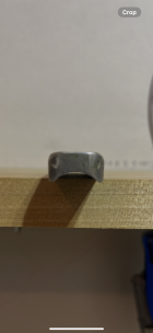

Click on loading ramps
You could try this but you might have to cut out a slot in the stock and glue it. As others have said the single shot actions the feed tray is milled into the action
This is the best option to use a repeater action in a 4.4” bolt spacing single shot stock.
With these all you have to do is to round the bottom side edges to match the same contour as the action and it will fit without any modification to the stock. It doesn’t need much and takes about 10 minutes to do.
