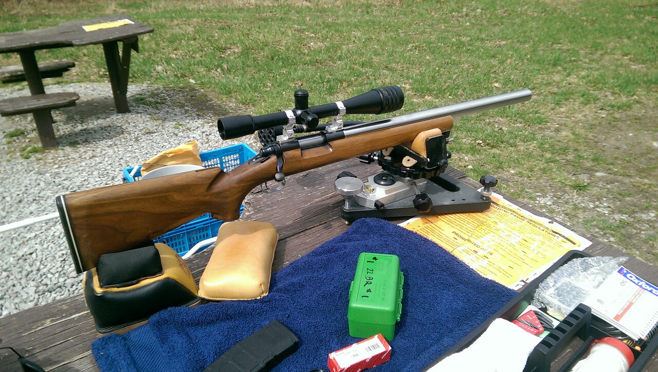

These targets were shot with an ex-caliber barrel. I ordered a 6mm, 7.5 twist stainless steel. The barrel was turned down to a 1" straight except at the breech end and finished at 26". It is attached to a remington 700 action that has been squared up on action and bolt face. It was chambered with a PTG 6BR reamer with .15 freebore. The whole thing was put into a Boyds Tacticool stock that has had the fore-end modified for a 3" flat. I have been working on load developement and had a bit of copper in the first five rounds and none thereafter. These target were shot last weekend with a 10-12 mph 1:00 oclock wind, almost head on. This is not a fancy rig but does show what the barrel can do. I welcome comments, but keep in mind it is a 105.00 barrel.

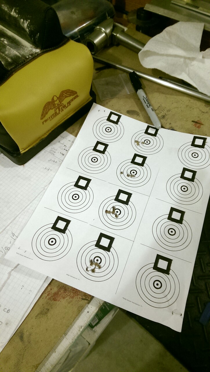

Here is a sample of what I'm getting so far. I got 50 cases fire formed....so hopefully I can get something working...
Ridgeway. I like that you posted multiple groups on one piece of target paper. I believe with a little work the groups will tighten up.
Messing with seating depth is a "fine tuning" step AFTER you've found an accurate recipe. Helps squeeze that last bit of possible accuracy from a load.
Looks like it will shoot that powder, but you need to try different charge weights way before you go changing bullets and messing with seating depth. Changing charge weight with a potentially accurate powder is the FIRST thing you do. Once you dial ONE bullet in accurately, then you can change bullets to see if it likes something else better if you want.

Yep...I'm quite aware. I've been running up my charges....I was just mainly concerned about getting the formed brass fireformed and while doing so looking for something that looked somewhat promising. I have several powders that I have on hand to try, so by all means I'm not finished.
