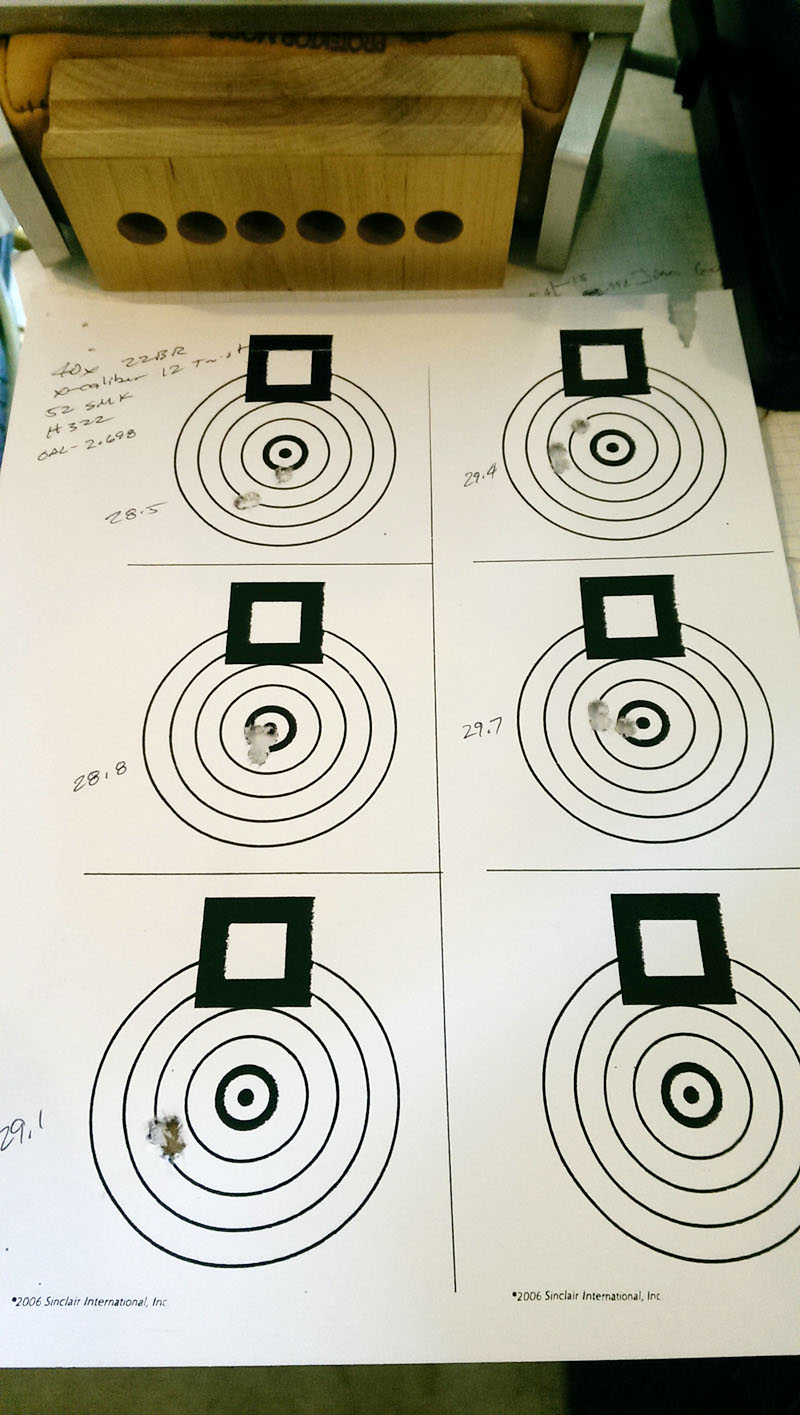

Its a 12 twist....actually 12.25. Bullets I'm going to concentrate on are 52 SMK's I think. They should do a number on a hog... :)

Yeah...its showing some promise. The fireformed cases should be of some help...plus I plan on trying some H322, 4895 and varget. It's a difficult stock to shoot off bags...I've been free recoiling it and takes a bit to get it back on target. Will be shot on a bipod or sticks in the field.
Started on some H322 with a bit better results...

I found those targets interesting as it looks like my 6BR targets. Looks like the 28.8 and 29.1 load were good, I'm guessing a probable node and when you kept moving up you found another node at 29.7 with a flier. I experience the same thing and settled in at the lower powder. Really wasn't much of a velocity increase with the extra powder.
I'm impressed with the results you are getting and really like that stock on your rifle.
Ridgeway, you have some shifting winds on that target for sure!

Can you post targets like Ridgeway posted. Several groups on one sheet of targets.

Thanks...its a bugger to shoot off bags fast!
Yes, for sure. Extremely twitchy day and didn't put out any flags. Just looking for a decent node to work on.
