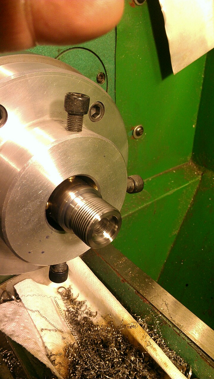

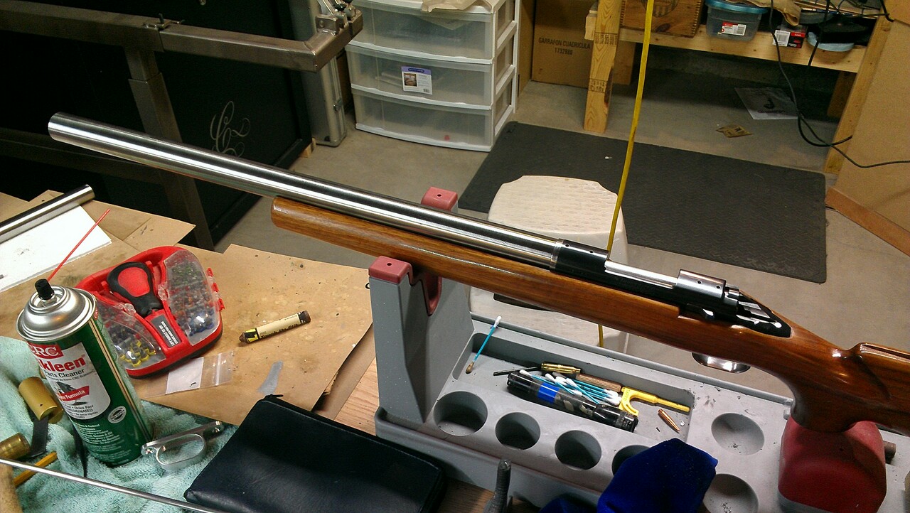

Got mine chambered and its almost ready to test. Chamber came out flawless with zero run out! Cut and finished up very nice. Just for kicks...ran the DTI on the OD of the barrel after I dialed the bore in....003".
Note...the hole in unfinished tenon is just a prebore hole. No pics of finished chamber/tenon. Also, just put a quick finish on it with a worn 600 grit belt and my barrel spinner. Finer work to come...
Waiting on scope, mounts(mfg sent wrong rear base) and install the trigger...
