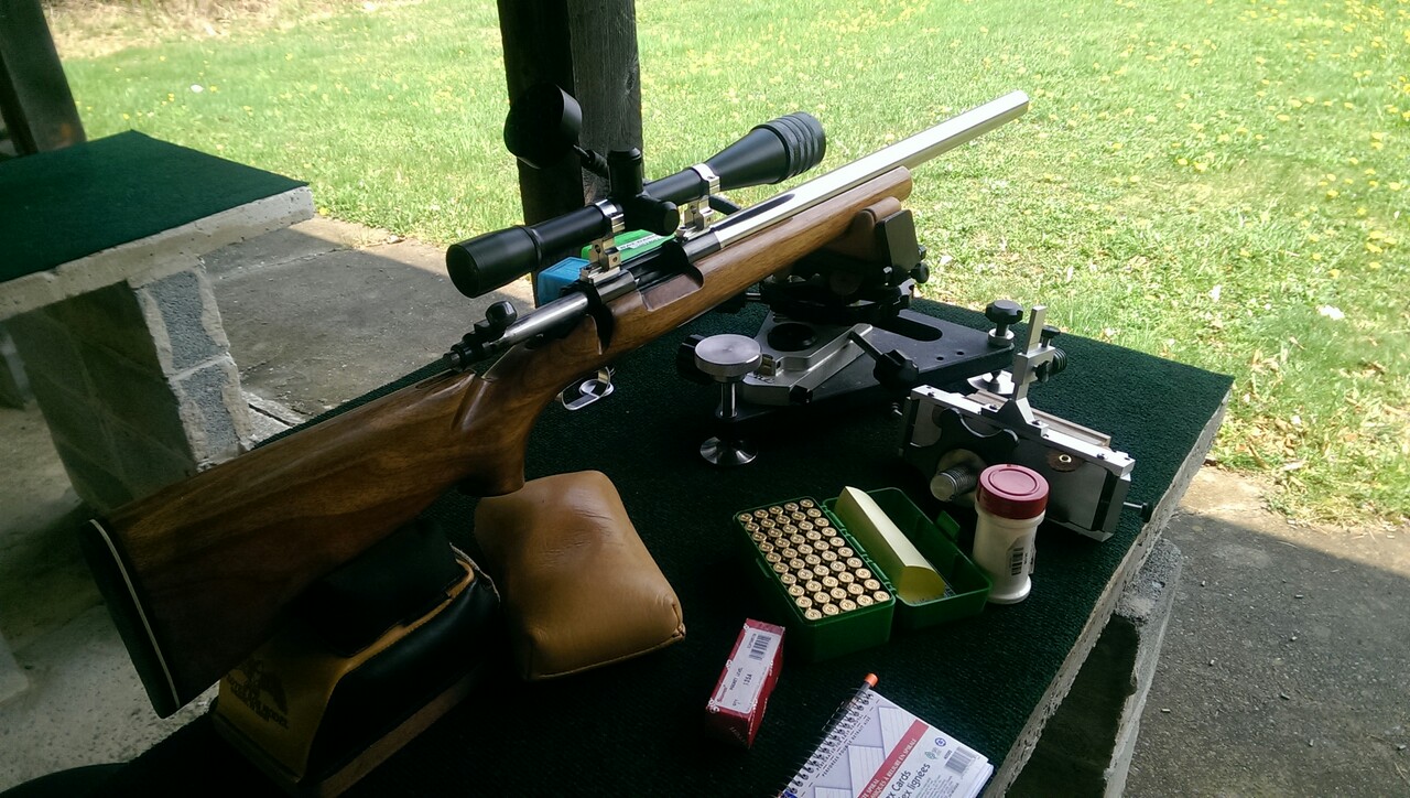

I was able to get some more testing in today and set up on a concrete bench. Showing some promising results with H322 and 52 SMK. Tracking is non existent in this stock, lol.
