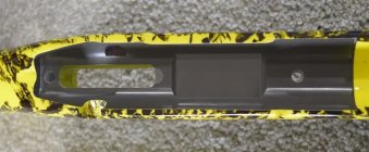

My current situation.
Using a piece of 1" aluminum round, I threaded it 1/4-28, screwed a cap screw through it and tightened the aluminum round stock to the action and coated the round stock with release agent. The action and lug is a very tight fit into the stock (too tight, actually). But this provided a nice guide to put the action and aluminum 'mandrel' into the stock. A thin, high strength epoxy is loaded into the area I'd opened up around the periphery of the original pillar. It's displaced around the 'mandrel' and fills the cavity around itself and pushes into the enlarged space....you can see the round stock below the edge of the stock.
By the end of next week, it should be bedded and ready for final finish work.
Good shootin' :) -Al

With the 'mandrel' pushed up, you can see the epoxy has been forced into the recesses around it:
This pic shows how far off the original pillar was side-to-side. A dab of 'glass around the edges before sanding will make the hole look skookum:
The taper on the bottom of the stock needs to be accounted for. This one is right at 1.5 degrees...it will get faced off and oriented properly:

Finished up the bedding and am happy with the results. There was one final insult ;) to the Kodiak and that was taking the blind rear action screw and making it a through hole. Doing this tweak on a Kodiak or Panda is very worthwhile as you gain at least three extra threads for purchase and eliminate the possibility of the action screw feeling tight when in fact it's bottomed out in the receiver.
A .211 pin gage is a nice fit inside the original threads:
A little center drill action establishes a good starting point:
A #8 makes a nice .199 hole for the tap:
All done except for a quick deburring. You can see the original threads and how much additional purchase this mod gets you:
Barrelled action tightened into the bedding, indicator at '0':
Front action screw cracked loose shows .001 movement. With the front screw tightened, cracking the rear screw loose shows no movement on the indicator:
I was pretty happy with amount of movement as I used these .500" head diameter 82 degree screws into mating 82 degree recesses in the pillars for a lot of contact area. With this much contact on an angled interface, the indicator will at times show some 'fake out' movement that isn't really there due to the fact that the screws don't 'fall away' instantly from contacting the pillar like a flat-to-flat interface does.

There's .125" of Pro Bed over both pillars. The top O.D. of both pillars is reduced a bit so the bedding also flows around the pillar and locks on to it.
