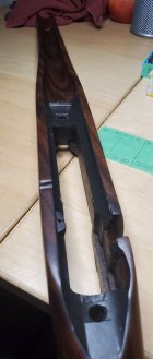

Here it is. Much happier with the results on this one. I need to rotary out the middle cavity, which I will do tomorrow afte the synthetic stock is done with its 24 hour sitting. I was impatient for this one to cure, so the last 2 hours I busied myself with grinding out the bedding and the recoil lug on the synthetic stock.

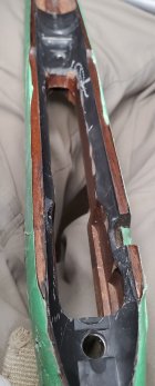

When that was done it was time to crack open the wood stock. Came apart very easily. Everything looks good. I was so pleased I immediately mudded up the synthetic stock using the randy Robinette method. No recoil lug, just the mud making the recoil lug.
Well... here's the near finished product. Just need to relieve the bolt knotch and safety inlet area.
Bad on me for the rotary tool runaway marks. Glad I don't do this for a living.
