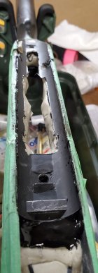

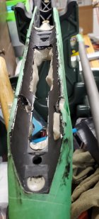

Well it's been 26hr so I popped it apart and took some quick pics before I ran out for an evening appointment. @AlNyhus your method for coming apart is idiot proof. Like you said, I rubber malleted the inletting pins, removed then, cleaned reinsert and then hit the underside of the of the barrel right in front of the stock. Popped right out. Easy peas.
These pics are raw and it looks like there is alot of Clean-up to be done.
Does the tang look right? I did not expect the tang to be lower than the bedding after it was done. I was trying to do the stress free method where the only two points touching prior to bedding was the very last bit of the tang (the area behind the putty plugged hole) and the barrel tape wrap.
Also I'm confused as to why the front pillar is a bit proud but the area around it looks like it is supporting the action. Maybe it's just the way the pic looks.
The bolt release/catch area is all weird. Like I forgot to put bedding in that spot? But I don't think that's the case. And just to note, I did bed the recoil lug permanently in this stock as a test of that mmethod.
Please let me know if you see any trouble areas or places I should re-bed before I start the final cleanup

It doesn't look terrible. Dremel clean up the problem areas and epoxy again, but i bet it won't matter as long as the tang and lug are done well.
