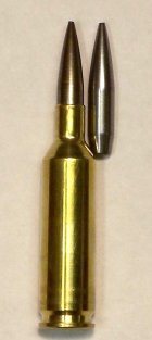

And will fit in a standard 2.800" mag box, while still keeping the bigger bullets above the donut area when seated in the lands.
All my 6 XC Reloads Fit easily, in the Standard, SHORT, Rem., 700 action.
107 gr. SMK's and 108 gr. Elites,.. NO Problem !

Re-read what I wrote, which I defined as the boattail/ body juncture of the bullet above the neck/shoulder juncture of the brass, and still be able to touch the lands. Plus it doesn't impede in the powder capacity, depending on powder of course.
The 107 SMK's "Jammed" into my .104 FreeBore, 6 XC barrel. has a COAL of, 2.690 inches and shoot's,..
in the Low 2's ( I'm Happy ! ) EASILY Fits, my 2.830" Rem 700, Magazine and NO touch em',.. Doughnut !

Rem 700 SS, short Action just,.."Works" FINE for up to, 108 gr. Elite Berg. Bullets @ .035 "Off" @ 2.750" COAL.

Where's the boattail/body juncture of the bullet?
Fished out, my Split Case, some 108 gr. Elites and Checked them, Just for,, YOU !
At a COAL of 2.750" the 108 gr. Elite's Shank / BT,.. IS,. WELL AWAY from, the Neck Shoulder, Junction.
Looks to be,.. .040 to .050 of "Space" to, Me !
