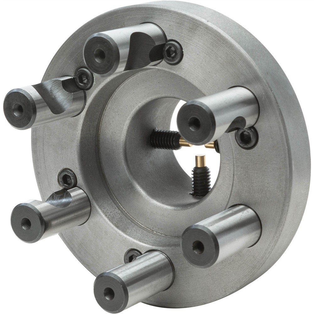

I guess I should have stated, if working on a rifle barrel, I'm using inboard/outboard spider. The rest of the time, if it fits in the 5C collets, I'm using it. I've got a full 72 piece set. The OP was saying 4 jaw or 6 jaw. I can see 6 jaw replacing 3 jaw but I'd still want my independent 4 jaw. But I don't use 4 jaw for chambering.

If I could only have 1 of them it would be a 4 jaw what it lacks in speed and convenience it more than makes up for in versatility. That being said I hate 4 jaw ind chucks and only use it when I have to. Next in line is the 6 jaw only con for me is the minimum gripping size is larger than a 3jaw of the same size. I luv me some collets especially the pratt collet setup. Keep in mind I got all this stuff over the years and did not have to go out and throw down for it I understand resource allocation for a home/ hobby shop and this stuff can get expensive in a hurry. All that said I do my barrels in a spider cuz my headstock is too long if I use the chuck.

Because of the length of my headstock I use a TBAS/6 jaw for muzzle work 100% of the time, no matter what length the barrel is. I had to get creative to come up with a way of not having to make sleeves for all the different tapers.
The Encore/Contender has a lug hanging off the back and would require a 2-1/2" bore to center it in headstock. I've never used a 6 jaw but don't think you could hold it. You can with a 3 lug and with a set-tru you could get it to run true. I finally had success getting good concentricity copying Mike Belm's method.
