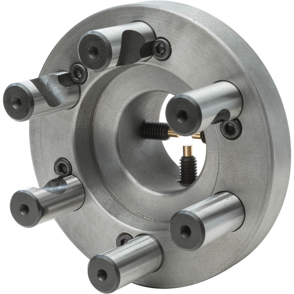

Picked up a 8" Bison 3 jaw set-tru months back on eBay. Didn't come with a back plate so ordered one from Shars and machined to fit, added some soft jaws all for around $250 total. It's about all I use now unless something is just to short then I go to the spider.
That is what I currently use, no complaints now... When I first bought it I was making split tapered sleeves to hold the barrels so I could do the crown/muzzle brakes. That got old real fast. I took some steel soft jaws and made a 3 piece set that lets me grab any taper, that made things much better. It’s pricey when you figure in a bison 6 jaw but i sure like the features.

I read the description and I must be missing something. How is that different than a 6-jaw set tru?
I'm going to mince my terms so I apologize in advance.
A set-tru centers your work.
The SSG set through, allows you to do that, plus the chuck pivots axially on a backplate.
So you can chuck up an action, or a barrel, and align the Z axis of your part

I have used the TBAS for several years for chambering, it is very fast to dial in, and once dialed in it does not move. If you can afford it I highly recommend it.
