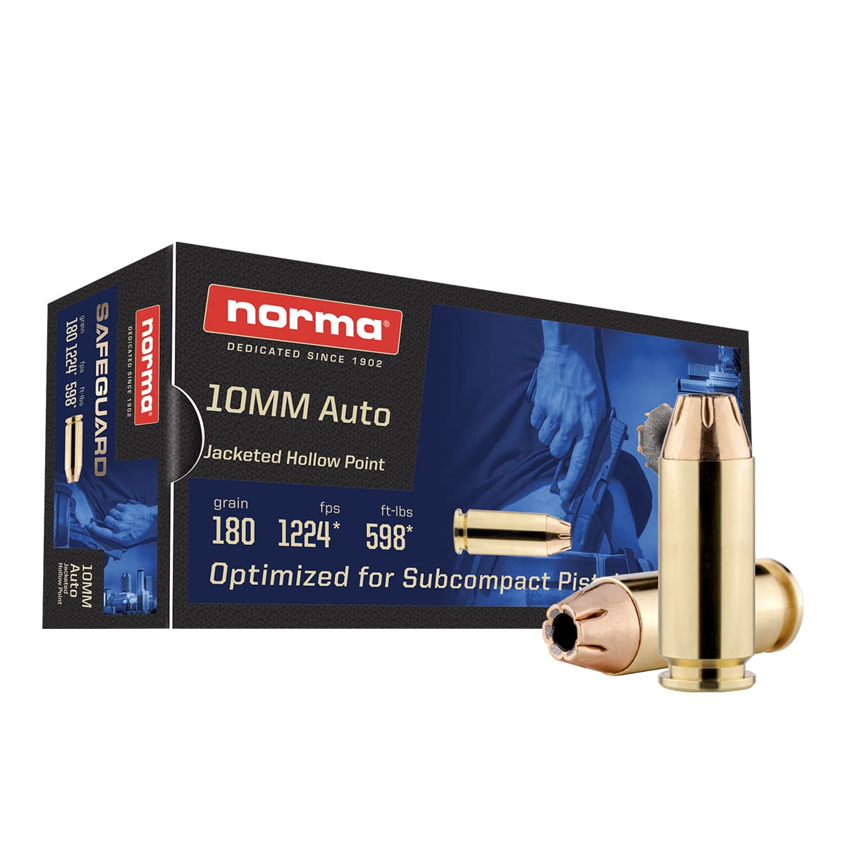

I run these on my Dillon 650 with Mighty Armory sizing die with decapper rod removed, mighty armory expander powder funnel in my Dillon powder dropper, Mighty Armory seating die and crimp die.. I have stupid great accuracy with these loading Montana Gold 200gr LSWC gas check, 200gr Sierra JHP and 180gr Norma Safeguard HP with W572, Longshot and N350....

No AA9 loading for me but about to do load workup with 180gr Norma Safeguard.. gonna test Power Pistol...
