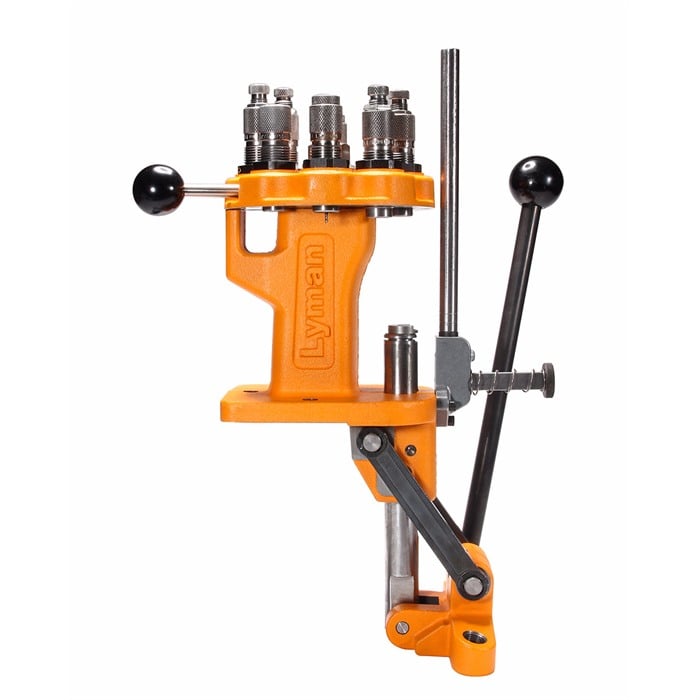

The nice feature of a turret press like the OP is purchasing is that it can be used as a single station press since it is manually advanced. Size and prime a loading tray of cases, advance your powder measure station/expanding station over the shell holder charge the cases put them back in the loading tray, seat the bullets them crimp them . A carbide taper crimp die is the cat's PJ's for semi auto rounds that headspace off the case mouth.
Easy peezy and don't have to be taking the dies in and out of the press after they are set up. Once the operator is familiar with the function of each die and has them adjusted to produce rounds that function in their firearm rounds can be run thru each station pretty quickly.

I've decided on this press...
Other than the 9mm and 10 mm dies and shell holders, what else will I have to have in order to be up and running.
I know I will need:
9 and 10mm brass
9 and 10mm bullets
Large and small pistol primers
Priming tool
Powder (2 lbs to start?)
Powder measure + trickle measure
Powder scale & funnel
Powder scale
Digital Caliper
and....???

From the looks of it, if I order this combo, all I'll need to get is the 2 die sets & shell holders (plus the consumables). I have some titanium-carbide dies in my cart @ Brownell's, but I'll check Midway before I "pull the trigger."
I don’t see the combo deal as a good value, there will be things in here you won’t use or you will wish you had got something more mainstream.
