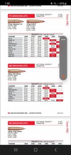

Compare his velocity to a 7prc or WSM, it might give you pause.
Velocity is achieved with less powder.
So I'm really not seeing the gain of the 7prc over a06 improved or a 280ai for that matter.
